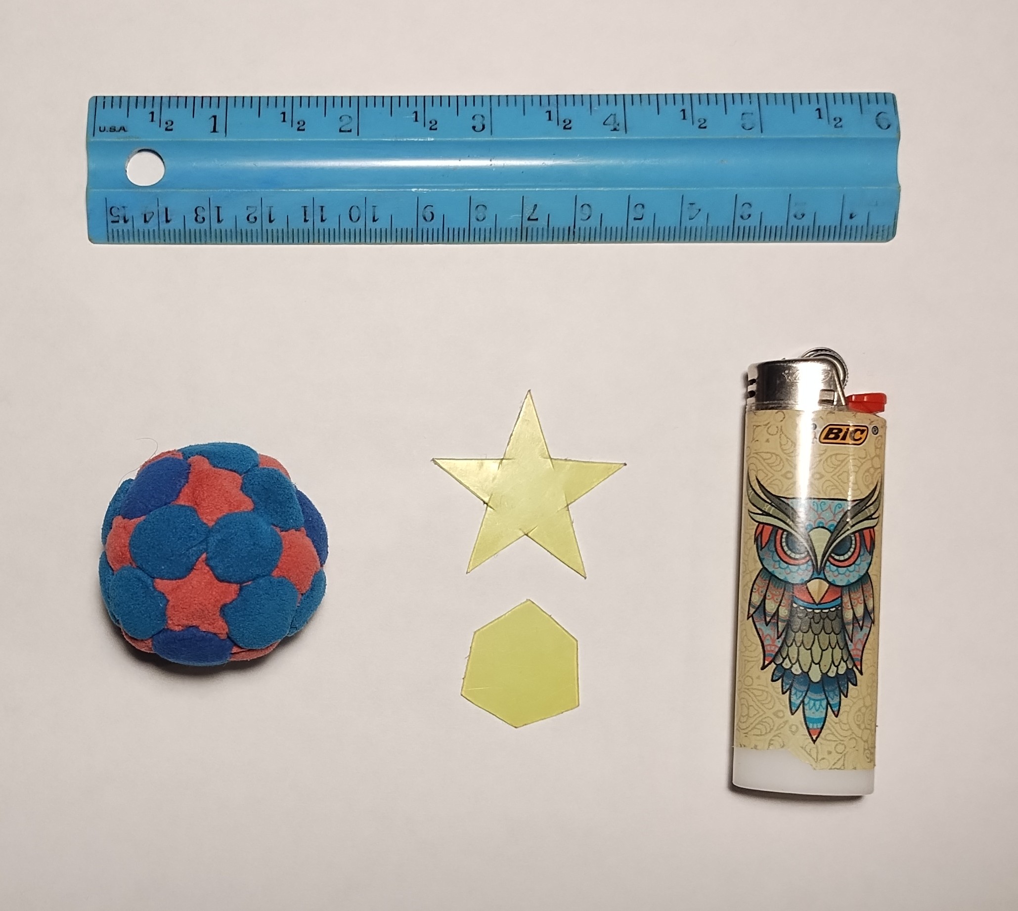

Forgot my Strix login. 11 years later. I made another bag. Included template for others.

Welcome back homie! Looks great!

Thank you very much Kevin. I'll be sure to post more bags in the near future. Both here and reddit.
